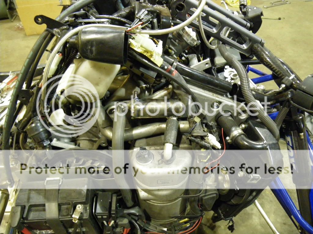

Time for an update here seeing as it's been a while. It turns out part of the cold start problem was condensation build up in the boost line had gotten into the efi box and after it sat out overnight this would freeze and trip the boost sensor causing the additional injectors to spray right from the git-go. So essentially it was flooding like #*$&@ until enough heat built up to thaw it. Draining the line and mounting the box with the nipple facing down helped but it still wasn't right. I sent the box to pg yam and the moisture had somehow f#@!*d up the mapping on the bottom, so they reflashed and tested the box. When I pulled the seat and plastics, I noticed that the heat from the turbo was melting some of the plastics and had hardened the boost line to the air solenoid. I have added a heat shield over top of the turbo.
One of the things that i have found this year is with the extra power it is very easy to flip this sled. It did spend a lot of time upside down last year too but with the turbo and whatnot I am a little paranoid. I decided to do some thing about this so I have built a catch bottle/baffle for the breather and will be building another catch bottle for farther down the line and running a k&n breather filter on the end. I assume i will still have oil leak out when upside down but hope fully this will cut down on it.
It still needs to be cleaned up and painted but you get the idea.
Taking advice from dumbass, I ordered a throttle cable for an apex, but I ordered one for the apex mtn. I don't know if he used the one off of a short track, but the mtn cable is a little on the long side, but will work great. The inner is longer in relationship to the outer than the phazer cable, so I had to build a plate to relocate the bracket on the throttle bodies that the cable threads into.
I've also put on my simmons skis with yamaha version 1 mounts for extra strength and am replacing some steering stuff. We have drags and hillclimb coming up as well as 7-9 days of riding so I'm going over every thing so hopefully I won't have any problems.
When I installed the clutch stuff, I didn't get the primary spring groove machined deeper, so I got it machined 4mm deeper to hopefully give a bit earlier engagement and quicker upshift.
[/img]
