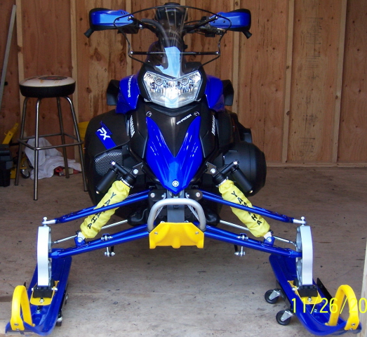

few pic's of the wife's phazer fx,silverstar bulbs, 1.075 gold diggers w/ blue backer's, ulmer clutch kit, slt ski's, air-box mod,optimate battery charger, just got to put in the tunnel protector's and still waiting for the excell exhaust to come out and snow to start falling.

That looks great. The yellow accents look very good.

yep have to agree about the yellow comes out nicely

what airbox mod did you do?

whats this Airbox Mod?

when i took the machine all apart to see where the oil filter was, i checked out the air filter, underneath on the air box there, there is a air scoop, i just drilled 10 - 5/8" holes above it to let more air in, i did it there so the exhaust wasn't as loud and no snow could get in, it seems to respond better, it seems that it took away the hesitation too

I like it. It's sharp with the skis and yellow trim! Look like its ready to rip!!
