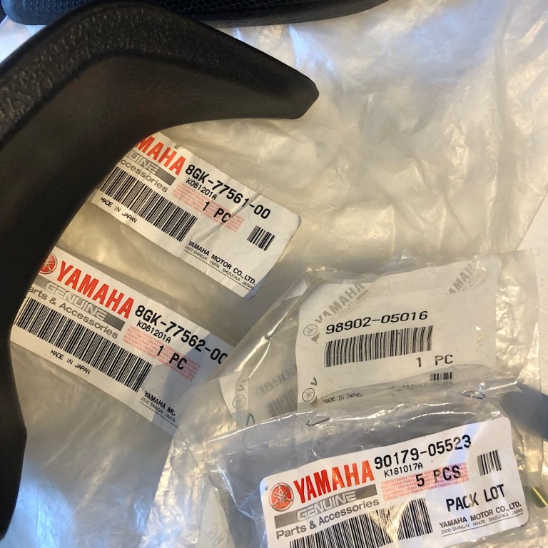

Where do get the air scoops?

Right from Yamaha. Dealer had pile in stock.Where do get the air scoops?
I looked up a 2008 Phazer GT to get numbers.
Easy to drill headlight cover as it’s pre marked. Was hard getting those lil washer lock nuts on tho.
I looked up a 2007 Phazer GT to get numbers.
Thanks for the info, I will see if I can order some from Yamaha.

Anyway. Bolted that excell on today. And installed those 2008 get scoops on head light and body panels as well. So easy, panels primaries on back just drill and mount.
