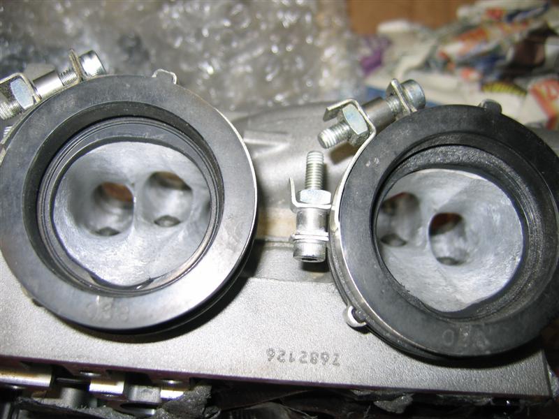

cannondale27 said:No flowtesting but I trust my porting guy to make power.Matczak Machine in PA has never failed me yet.Nice head!Would like to see your car.Is a whole topic with pics of my head somewhere.I told him I wanted topend power since I feel I can afford to lose some low end and not suffer.![]()
Interesting. A motor builder that has some experience in the Phazer Head.
I believe his name on TY is Snowprophet.He also has a Turbo Apex,Drag Banshee,Ported SRX and a fully built V-max.All are crazy fast!Probably not best idea to post pics of his work but I believe I asked him first time I posted them.Its a artform anyway.Some people just have the skills.I know he does do flowbench testing on other heads but it wasnt asked for on this one.

looks real good cannondale.
