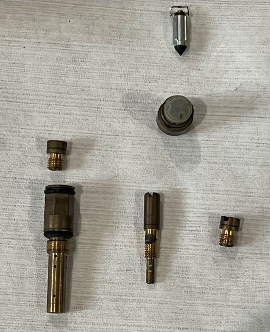

You couldn't have been more right! Wow these things are full of crap!!! Do you happen to know what size ofYou need to clean the carbs before you spend money on anything. Take all the bowls off, clean them and clean all the jets as well. You probably have gasoline varnish residue gumming things up in all the tiny passages. After all of that, you may need to sync the carbs as well if you can't get a steady idle. Do not replace the coil packs, they last for many thousands of miles, and the aftermarket ones generally don't fit properly.
orings for the main jets, mine are garbage.

I agree with thrasher, don't change out the coil packs. Very rare for them to fail. The three cylinder do not interchange with the 4 cylinder and vice-versa.
Also, I've seen instances where the aftermarket list them wrong.
Clean carbs thoroughly and put new spark plugs in.
Should be able to get new 0-rings from Yamaha, or most automotive stores.

Got it out, found stainless screw at the hardware store. All 4 are clean, all jets and passages. I left the main jet o rings off.
I didn't mess with the air screws. Wondering if I should set them all at 2 turns out or leave them be? My riding is at 5000 ish ft here.
Do you mean one of these o-rings? Not sure that's a good idea.
