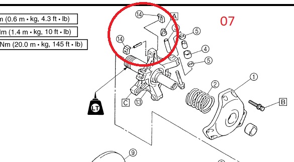

I cant believe they messed with this. This may just be the reason behind alot of the trouble people are having with clutches. Very dissappointed since once again they messed with a proven system. Who cares if its noisy and rattles. So does a Ducati!
2015 Primary has a O-ring in the pad. Previous primaries did not. It was a loose fit. Why?
Previous Versions. Looked at Apex and Phazer this is how they are or were.

Didn't that o ring get added mid Nytro production like around 2010?
Allen mentioned this yesterday when we were discussing my clutches. Explains my drag, but I think the 2014's did as well.

I know my Viper "sticks" in place with no spring pressure/cap removed. My 2010 Nytro is the same..

My 2009 Nytro as well.

The o-rigged slider also turn a little bit wich seem to make the clutch harder to open/close. I always reposition them when I open the cover.
So you guys don't see this as causing it to stick especially if dirty? It's very noticeable the difference when compared to other primaries I have.
These have been is use for a while, same as my 2011 apex. Never a problem on that sled.
