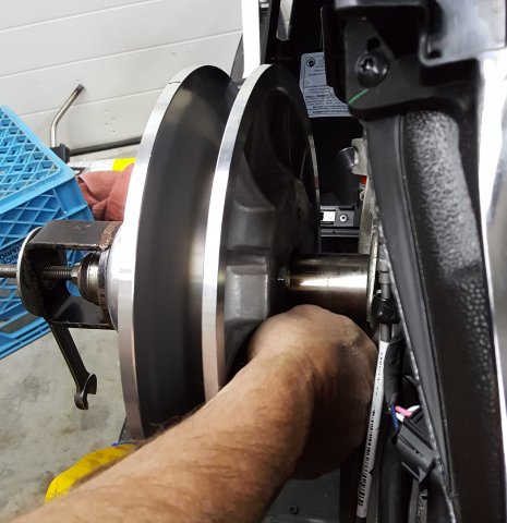

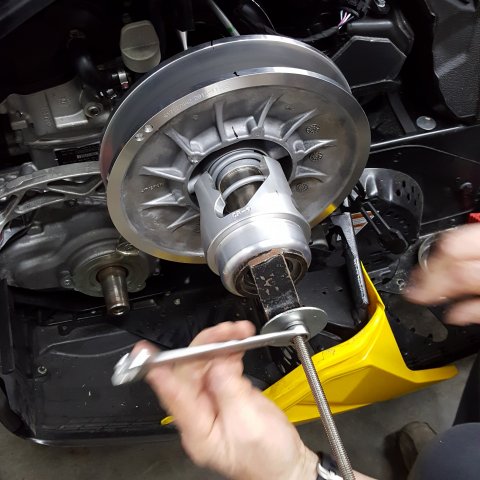

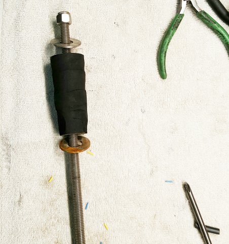

I just helped a bud install new clutch stuff on his Doo.holy crap..if someone gave me a job to design the worst possible secondary set up I could not have thought of that...If it was an 850..you have to pull the jackshaft to get the helix off...it is a 1200 ....4/ and as it was I had to make up all kinds of special tools..
The thing carries the skis..he is happy..
