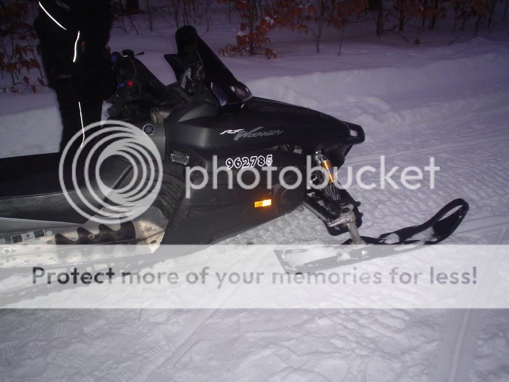

i would reccomend the cr10ek's for plugs if the previos owner did not have them in there already.
i do not run the k+n's but regular pump gas is all i run. i have the holtzman carb springs in mine as well.might want to check and see if some clutching has been done but you will not be able to tell if it is right untill you run it on snow and tell us engagement and peak rpms.
hehe mine used to look like that but i think it looks better now as do most people that see it.

Sorry for taking so long to reply.. Life has been very hectic the last month..
Those are VERY nice pictures, thank you for sharing!! I really REALLY like the color change!! Mind if I steal your idea?? Looks like a spring project to me!!

grashoper said:Those are VERY nice pictures, thank you for sharing!! I really REALLY like the color change!! Mind if I steal your idea?? Looks like a spring project to me!!
lol no problem. i saw one done like mine on here and copied his. everyone who sees it loves how it looks. we just got dumped on with snow so some new miles might be getting on it with my new to me ice ripper.
