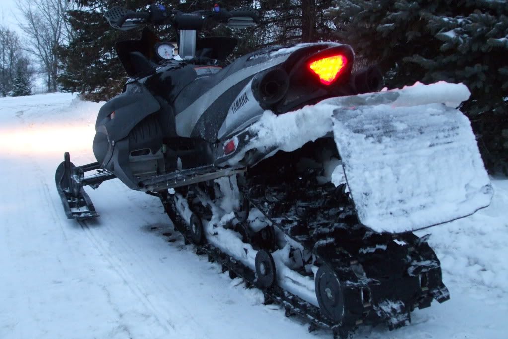

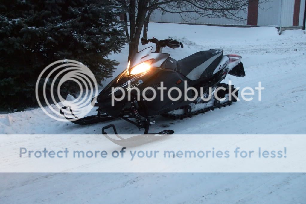

I have a 2007 Apex RTX and extended it to 144" using the rail extensions.
But I am running a Arctic Cat ZR skid.....I had to make my own drop brackets to accomodate the TSL but it was easy and would do it again.

The track will fit just fine with the tunnel protectors removed and the 7 tooth 3" pitch drivers. I'm running the exact same size track/drivers as you except it's a Maverick.
If I were you I'd go a whole different skid - 121" to 153" is a huge rail extension. I have a Polaris Switchback skid with tipped up rails and it works great - I really like the 153" on the Apex.
