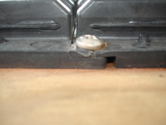

I went with Injection Plastics ski guides http://www.injectionplasticsmfg.com/products.asp which are 15" long. (I used 28 of them on my trailer.) There are no holes at one end of each section because they are designed to overlap each other slightly. One end of each section is relieved on the top side and the other end is relieved on the bottom side.
The overlapping end of each section has the holes at the end so it secures down the end of the other section that it overlaps which does not have screws in the end. I also installed "Ez Load" ramps at the end of my trailer deck to help the sled over the end of the trailer deck when tilted especially when not on level ground. Here are some pics of my much less impressive set-up LOL!
