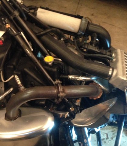

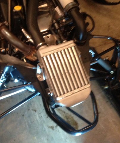

View attachment 97788 Even the turbo does not have a radiator in the front of the hood only an inter cooler. However you must remove front end panels to check coolant.
Pretty sure the MPI has a radiator still. At least I am pretty sure I saw on on the demo sled in South Dakota. Anybody know for sure?
Oh wait, you mean the pic above is a pic of 100 Cat....duh!

Yep, 1100 Turbo Cat!
