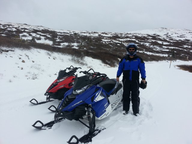

I took my hood off and also split where the radiator fin/vent is and put pre filter screen between and reassembled. As I deleted the radiator I wanted air flow but no water. Wish I had snow to test.
stingray719
IT WORKS!!!!!!!!!!!!!!!!!!!!!!!!!!!!!!!!!!!!
Fan now takes cool air from the front air intake and blow it through the radiator.
Tested today for 3 hours. Ran at between 25 degrees to 35 degrees at 10k to 12k altitude on about 4 inches of snow on the road. The test,
1. Blue Viper radiator delete. 172 to 174 degrees for 3 hours of slow stop and go riding both ice scratchers down. Disclaimer -NOTE: worked for me do not do radiator delete.
2. Red Viper fan reversed. 160 to 174 same conditions but ice scratchers NOT down. My big concern for fan reversal was 10 to 30 mph riding and it passed with flying colors. Disclaimer - NOTE: do not reverse fan connector
I put the disclaimer in as I am still testing. One trip does not a victory declare.
Pic from todays testing

Last Saturday I had the chance to finally give my Viper a work out. The Viper ran around 160 to 170 all day in the deep powder. I let it idle for about 4 to 5 minutes and it rose to about 176. The cool air under the hood was a big plus for me.
Now as a disclaimer do not do this as your experience might not be the same as mine, but I am not putting the radiator back in until I turbo it.
That's encouraging.
What ECT does the fan switch on at?
