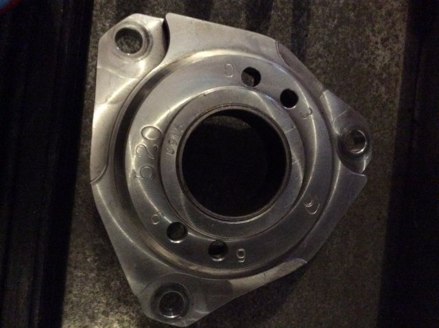

Weasel33 I had a bender racing clutch set up. I know it was dalton helix , not sure of weights will post pick to see if anyone can tell me what they are. I had to pull it out was not good. He was very secretive with his info.
The old Nytro setup was not much of a secret, and the Nytro setup did not work for me. Funny part is Bender Racing has the COTC recipe I gave it to them.
