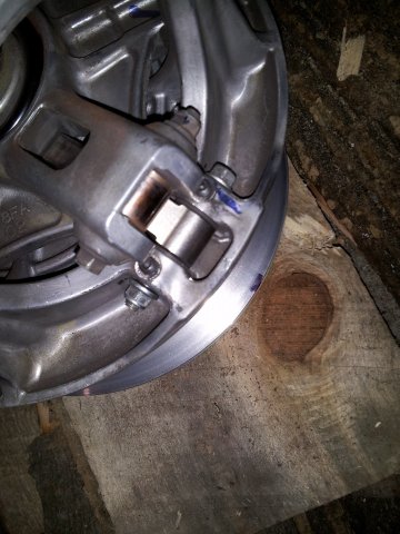

The black mark has about .120" from the top

I am jealous my marks are 3/8 to half inch from the topView attachment 104938 Got the clutches back from Cannondale and saw the black mark you guys put on there. Nice to see the clutch is really working at it's fullest
The black mark has about .120" from the top![]()
It was wiped off with the tighter secondary wind. Wish we would have marked bottom of secondary. Bet lighter wind gives same or better speed without need for primary shifting so far.
Studroes Magnaforces with 1 more magnet in each,Ulmer Helix shimmed,Stock pink spring 3/3 wrap.What weights were used in cannondales Ulmers setup?
