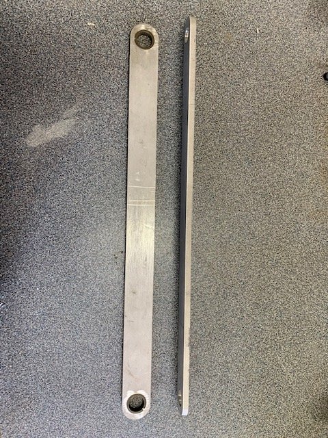

2016 Apex LE Front End of relay rod where it attaches to the bolt going through the front of the rear suspension shock worn through, and came off, caught in the track, and sled came to an abrupt halt. Is this common with these relay rods? About 5,000 miles on sled. Other side was just about worn through also.

working on an updated stainless steel upgrade for these relay rods. Have heard they are weak link.

I have never had one let go.. I have 17000 miles on one of our Apex's but good to know you have something in the works just in case.

his is a 16 with single shot. It is just the single shot relay arms that fail

Oh, those that go along the shock length.. good to know I have 2018 Apex 146

i had a warrior that those broke on once if its the same type of rods

My nytro rtx se has these relay rods and the ends do wear out. I believe Schmidt bros made aftermarket ones for the nytro.

I'm in for 2 when you have them done.

Will be adding them to online store this week.
