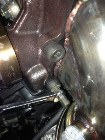

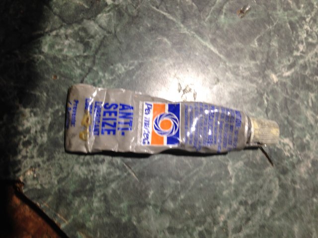

I've got 35 miles on my sled and mine were seized. I sent an email to my dealer with pictures showing the seized bolts. I was able to get 2 out, EZ outs didn't cut it. I had to pretty much drill the complete diameter of the bolts out so what does that tell you. The last one bit me in the butt and the bit snapped about 1/16th from getting through. The dealer said the Yamaha rep would like to inspect my sled so it's going in tomorrow. I hope they help me out, I'll be disappointed if they don't especially since I've bought 3 new sleds in the last 3 years. I do hope people read this thread and take action before they get in a jam like me. You have no choice but to remove the exhaust to get at the chain tensioner so it's only a matter of time before more people run into the same problems I'm dealing with.View attachment 124200 View attachment 124199 This is a thread people should read. If you EVER PLAN on taking your muffler off. Maybe chain adjuster? The bolts get so hot they almost weld together. If possible a guy should pull em and anti seize the piss out of them. Especially new with no miles because they are ALOT EASIER TO GET OUT. This is going to be a issue for guys down the road if they run aftermarket or what have you. The one photo shows how to pull the tight spacing ones. The other is a friend of all turbo exhaust bolts.

to remove bolts...
take a torx in a socket drive....if you remove the bit from the socket....now you have just the torx bit....take the boxed end of a combination wrench that mates to the bit 5/16? ...take a small piece of electrical tape to the end that going into the boxed end to snug it in...now press the bit into the box...now you have a wrench with a torx bit sticking out of the boxed end..the tape keeps keeps the bit there...
if your bit doesnt grab the stud well...you can dress it on a grinding wheel to bite better
now get a mapp gas torch...not propane...mapp gas burns much hotter....get the stud hot...try to concentrate your heat in the center of the stud.
of course wear thick safe gloves..and now your mini wrench will loosen with ease.
if for whatever reason it doesnt .....or stops and gets a tight spot....reheat...
be patient...heat is your friend...

This will be a MAJOR issue for guys down the road. Mark my words. No way the average guy that trying to get at chain adjuster does not have problems here. Recall them and run bolts

Mine were switched to bolts right away
Just curious what type of bolts you used? I would like to do the same. Do they need to be hardened bolts? Where did you get them? Thanks!
- Apr 14, 2003
- 6,539
- 3,172
- Hessel, Michigan
Grade 8 hardened bolts (M8 x 1.25) with anti-seeze.
Should be able to go to any hardware store and get them. Just bring in 1 off of the sled so they can get the right thread length.
