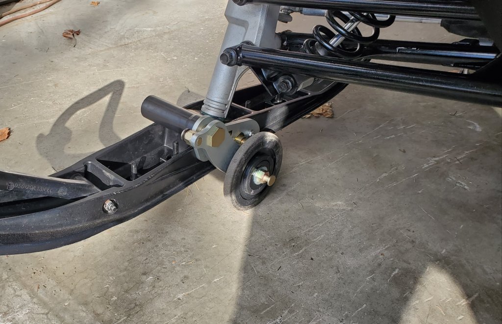

I installed yesterday, very easy install. At the same time I replaced the. Small babbit bushings in the spindles. That really took any slop out of my steering. Wow!

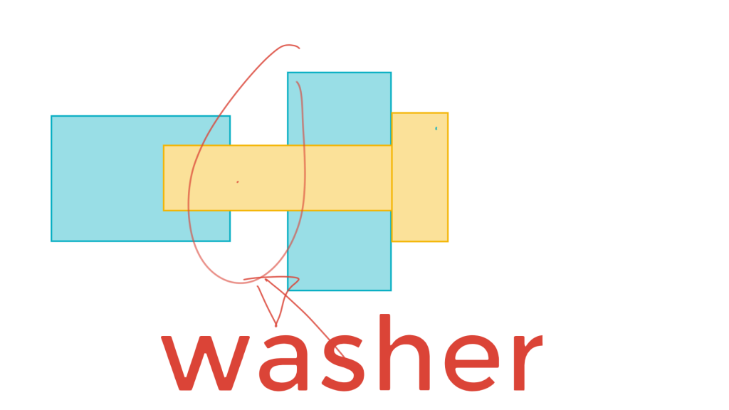

Yes I understand what the person above was talking about. The shaft seems to be too short. I put a spacer in between the spindle and the ski edge. I had the same spacer when I had the stock setup. There is normally side to side play and I eliminated it with the spacer in the past.

The nub is small and certainly would be better if it was a bit longer. That said I found it very easy to deploy. The weight of the sled is mitigated as you are lifting the ski and moving the wheel with your foot.
They work very well. I drove out of garage down the road and back in the far driveway. As soon as I got on grass the wheels flipped. So did my wife because I carved massive channels across the front lawn
The really cool part is in and out of garage. No more fussing with those horrible dollies.

Yes there pretty cool. Suggest you get a longer bolts to verify your using (catching) all the threads in the rollerski lost by the spacer.

You are correct with respect to bolt length. You need 1.5 x diameter. My current engagement is 12.8mm. Not dramatic but I am certainly going to upsize as you suggested.
