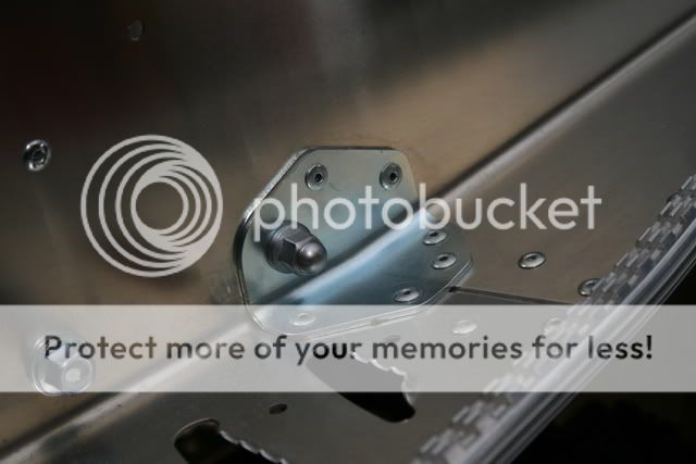

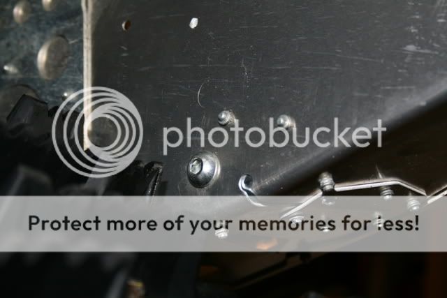

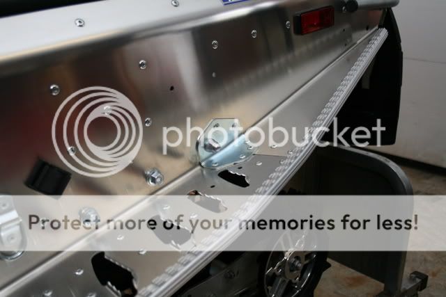

Reinforcement plated installed
Alatalo
- Jan 11, 2005
- 1,420
- 973
What does it look like on the inside of the tunnel...? Some kind of plate or just the bolt for the nut...?
Also, what is included in the part number for this kit...? If you order one piece of this part number, do you get plates for one or both sides of the tunnel...?

Here is a pic: Inside
I would assume the part # is good for both sides but not 100% sure. Check with dealer.
Alatalo, I have checked that allready and regarding my dealer you have to pay 900SEK for the plates, ordered seperatly@450SEK each. Its not covered by Yamaha Sweden.
