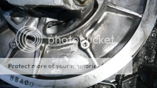

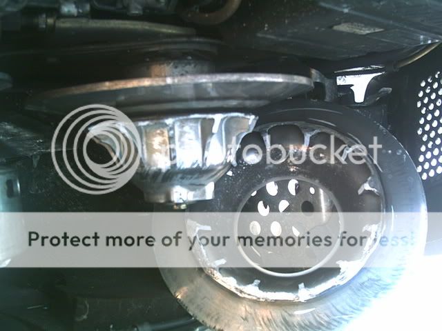

Hairline cracks in my Secondary…what’s going on?
This is what’s going on…
What happened?
I have video that helps explain the list of events, although a cause is yet to be determined, have a look:
http://media.putfile.com/FX-Nytro-MTX-P ... ne-Failure
What happened?

Do you think the hard 8DN belt has anything to do with this.....powder, hard belt, slippage and WOT running. .... this might explain the secondary, the oil leak...no idea..??

YES - I have news.
First off thanks to Force One in Yellowknife for getting the sled in right away to have a look and see what needed to be ordered.
It looks like the oil leak is my fault.
My engine is fine, thank god, but …when I did the oil change I accidentally left an extra o-ring on the oil filter – it was spitting oil through the extra seal.
The extra seal has been removed and the oil is topped up, the motor is good to go...
BUT...
The secondary is definitely screwed. Force One placed an emergency order today and i'm waiting to hear about availability.
I went back through my pictures and I didn't take one with the oil filter off. I swear I checked to see if the o-ring had come off the old filter and stuck on the motor, cause it says to do that right in the manual, and I remember wiping down the area that the filter connects on with a rag and it was bare metal. I must have missed it - oil filters can't come with an extra o-ring on them can they? lol
I don't have the oil filter to check it for the missing o-ring. Damn. I guess I'll never know for sure.

Is the secondary failure related to your engine issues? From excessive heat?
