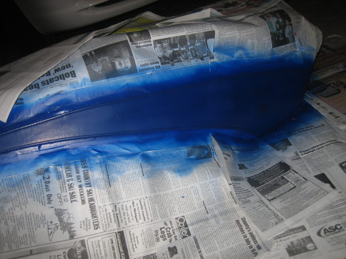

I used VHT vinyl dye blue on my Apex RTX. The stripe was red. I am extremely satisfied with the results. After 2 years and 10,000 miles there are only a couple areas around the seam that are wearing. You can not even tell from a distance. The actual color is a little darker than the stock color. I am guessing that is mostly due to the seat orignally being red. I used almost the entire can when I did the job.

did you use the VHT prep stuff too, or just cleaned it up really well?
mdkuni
I used some Biokleen Amazing Cleaner and cleaned the heck out of it with a toothbrush. Let it dry then painted it.
