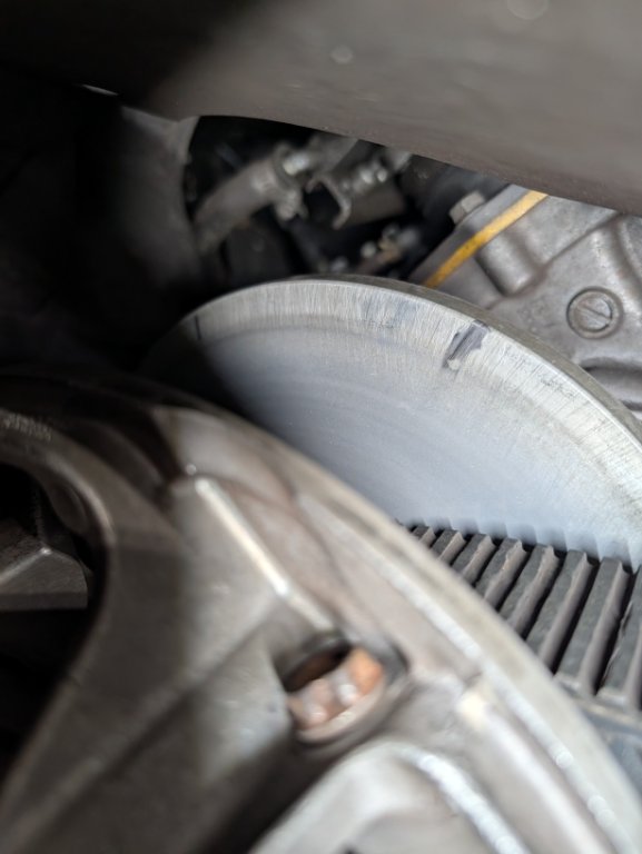

So this is what I'm seeing with just ditch railing. I haven't been able to open it up on the lake as conditions have been terrible. I marked the secondary at a few different spots and will check it tomorrow.
It's spinning about 8k from what I have seen. It has about 160 studs and a 1.25" track, so it's probably brining it down a bit. Again spring is stock cat as are weights.
