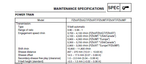

well...figured everything out. when the sled rolled off the trailer (the very beginning of this long saga) the front frame must have bent about an inch, the primary is about an inch too close to the secondary so there is too much slack in the belt. thus the belt not getting to the top of the primary...Does anyone have the measurement from the primary to the secondary so I can see how far its off? we'll say outside of primary bolt to outside of secondary bolt? I couldnt find this data in the service manual. The next question is I wonder if there is enough adjustment on the motor mounts to make up this massive amount of slack.

I measured 11-5/8th from outside to outside, both on the "flat" edge of the bolts.
Maybe its just one of the motormounts that came loose or broke since the subframe would have nothing to do with c/c distance of clutch.Here is center to center distance.It also can be measured by going in between the sheave of primary and secondary.Will have to look for that measurement though.

Measured the distance between the clutches, 11in 5/8ths so within spec with above post...once again back to the drawing board on why the belt doesnt get to the top of the primary. At least nothing is bent in relation to clutch fore aft spacing. Saga continues...
