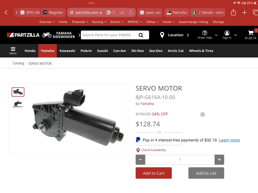

Hey ActionJack, I’m having this issue as well, just want to confirm this is the part you replaced to fix the issue?I'm guessing you need a new actuator. Go to the regular Sidewinder thread and dig thru to SD-08/Reverse problem threads. You describe my experience closely. I pulled the thing apart, found the metal gear, cleaned and regreased it but it didn't work. Took to dealer due to warranty and they replaced it. I keep a spare one at camp with sled.

YepHey ActionJack, I’m having this issue as well, just want to confirm this is the part you replaced to fix the issue?View attachment 171182

Thanks again. That part fixed the Sd_08 reverse error. The local dealer actually found they had a new version of this part so hopefully they fixed whatever caused it to break last time. New model number is 8JP-G616A-20 if anyone is curious!

Good news that solved your problem. I think generally that actuator is just crap. I've read about them having corrosion on the connections, stripped plastic gear that can be "re-clocked" to use good teeth on opposite side and seen videos of people taking the actuator apart and regreasing them with success. Mine did not have the plastic gears nor the corrosion but did seem to have a grey pasty grease that was sticky. Mine was replaced under warranty.Thanks again. That part fixed the Sd_08 reverse error. The local dealer actually found they had a new version of this part so hopefully they fixed whatever caused it to break last time. New model number is 8JP-G616A-20 if anyone is curious!

Yeah I think I had the same as you. Metal gear and no signs of corrosion or anything but that sticky grey paste. Nice when your snowmobile fix is a simple little easy to replace part like that haha. Part was $245 CAD but I’m happy it’s fixed.
