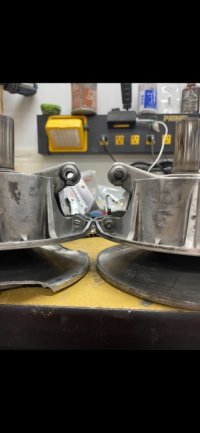

The clutch on the left I both picks is a older apex clutch
The new one in pic is one o order for a viper and the old looking one on the right is original 2017 sidewinder clutch
Looking and measuring and comparing I can’t see any diff other than the set screws
what am I missing

Sidewinder clutch the arms and rollers sit on on a larger circle than the old clutch.
There are other differences in added webbing to the winder primary. Along with what should be a stronger spider on the Winder.
In reality the old primary has proven to be stronger and more consistent with very much improved belt and roller life. I couldn't keep rollers in the winder primary, and belt life was dismal at best with the big tunes. Old RX-1 Primary fixed all of the issues.

If you really want to you can drill and tap the spider where they normally are, not a big deal.
Without climbing into my shop attic to look at the clutches in parts heaven if my memory serves me right the apex clutches have a slider on the spider and the SW clutch has buttons.
The fixed sheave diameter is the same on both clutches but the weight pins for the SW clutch are further out on the sliding sheave.

The pictures you have don't show any sidewinder clutches, these are previous style Yamaha clutches. Not Sidewinder clutches.

Earlier style compared to the Sidewinder clutch...yes. To me the Sidewinder clutch should be recalled...LOL
As far as earlier clutches from having the set screws compared to not having the set screws....no. Now that we sell the anti-rattle/anti-movement washers, the clutches are the same.
