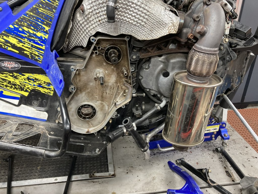

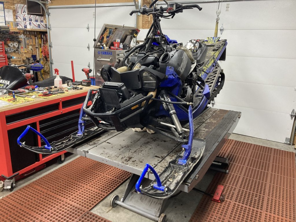

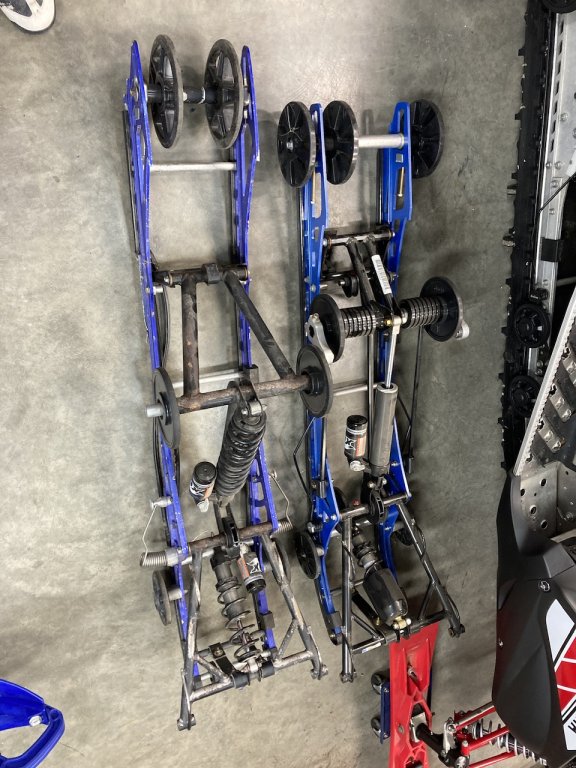

Here is a Winder project with lots of damage. Ripped down pretty far. Rebuilding the front end on it and adding a shorter skid and track.

What the heck happened to that thing?
Is it yours?
What is the end goal?
Is it yours?
- 21,912
- 9,498
It’s not mine. It’s farmers. Trying to fix it so it can be trail ridden. It can be done.What the heck happened to that thing?
Is it yours?

It was ridden off trail, into trees over rocks thru brush rolled and upside down. Put away wet!!

You build something with popsicle sticks and tape and this is the result…… can’t take much abuse. Nice to see you bringing her back to life Tom, good job.

Many of the combinations at once over and over. It’s been thru hell and back.All at once.....?! LOL
True. Very cheaply built machine that we pay a premium for.You build something with popsicle sticks and tape and this is the result…… can’t take much abuse. Nice to see you bringing her back to life Tom, good job.
- 5,723
- 4,313
I certainly don't like the way the tunnel attaches to heat exchanger and the rivet quality is poor, but aside from that the chassis is good and can take a good pounding.You build something with popsicle sticks and tape and this is the result…… can’t take much abuse. Nice to see you bringing her back to life Tom, good job.
