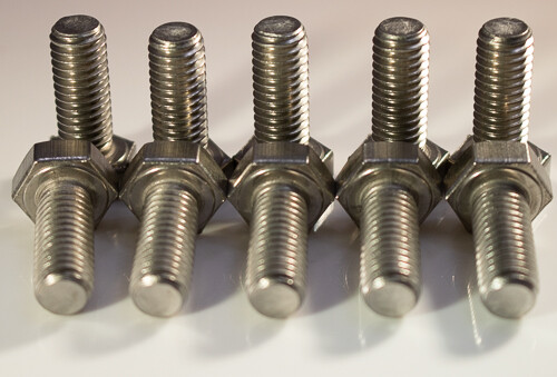

Other option is to have a nut welded on. ALL the exhaust bolts should be coated with anti seize. I remove the stock ones and replaced with stainless bolts. I replace and use nickel anti seize on mine every season. Nothing like a broken bolt lodged in a hole! Lots of fun. At least it’s not January and snowing out. You got some time to fix this.

"Nickel does not react with any metals, and also provides superior heat resistance and a better lubricating quality. Copper Anti Seize Corrodes Stainless Steel and Works Only To 1800°F (982°C). Nickel based anti seize works to a temperature 600 degrees higher than copper based anti seize" Information found online
