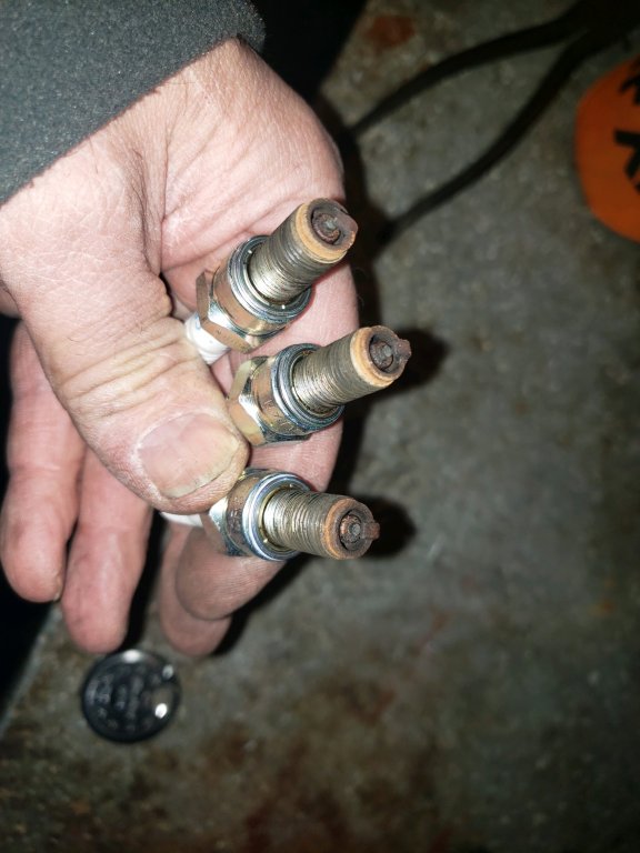

Today I changed all 3 spark plugs from the muffler side. Used spark plug tool out of kit to loosen up the plugs. Spark plug socket with plug in it will not come out under gas tank.
Screwed spark plug in one turn, removed plug socket. Used a piece of vaccum line to put on spark plugs to remove from head.
Gapped new plugs and used rubber hose to get started back into head. Tightened up with spark plug wrench from kit. Put some electric grease on boots and installed. Had to slide hood forward some to push coils back on all the way.
Starts and idles great. My sled has never idled this good.
Old plugs were .029, .030 and 032".
Over 9000 miles on original plugs.

9K!! wow . don't wait so long next time?Today I changed all 3 spark plugs from the muffler side. Used spark plug tool out of kit to loosen up the plugs. Spark plug socket with plug in it will not come out under gas tank.
