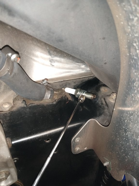

Sparks plugs are without a doubt a 15min job. Coils pop off with simple leverage, 3" extension on the back two plugs, a swivel with 6" extension on the closes plug.
Unless of course your 5/8 plug socket doesn't fit on plug snug enough (add electrical tape) and the plug drops into the abyss, between the tank & aluminum shroud. Better add an extra 15mins. Ugh....
Lol...
Been there done that...LOL...what would we do without our telescopic magnets!Sparks plugs are without a doubt a 15min job. Coils pop off with simple leverage, 3" extension on the back two plugs, a swivel with 6" extension on the closes plug.

Lol...
Bob, the two closest plugs came without incident. As soon as I got to the plug furthest away and heard that noise that sounded like a pinball machine....I knew I'd be in for a ride...lol
