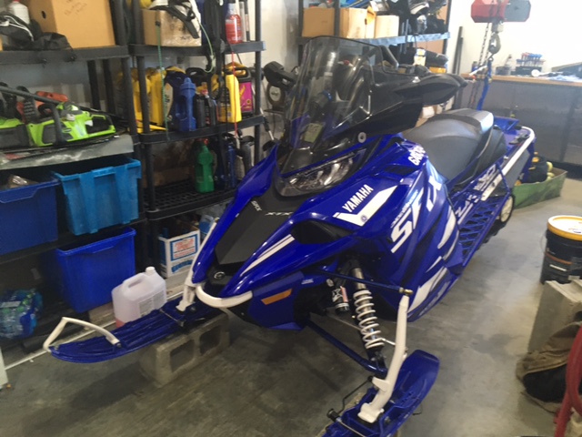

I just completed spring maintenance on my SW and put the sled away ready to ride next winter. Feels good to have it all done.

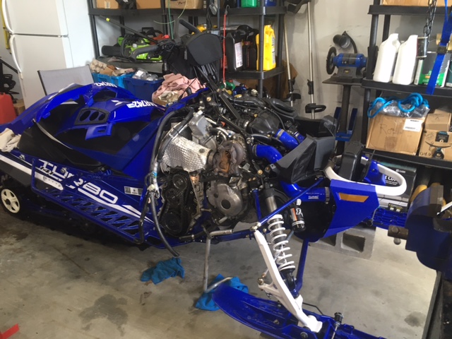

I had most of the sled dismantled to check bearings, bushings, hoses, clamps, wiring ect ect.
I was amazed at how good every thing looked and never found anything that really needed immediate replacement.

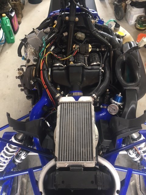

As well as normal maintenance I did some upgrades some of them that I had been putting off for the last few years.
-BOP auxilary rad/fan kit
-Dasa racing billet water pump impellar
-adjustable fuel pressure regulator
-DMC top gear bushing
-2022+ updated drive shaft installed with both BOP shaft saver and bearing
-PEFI chain case adjuster

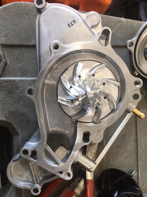

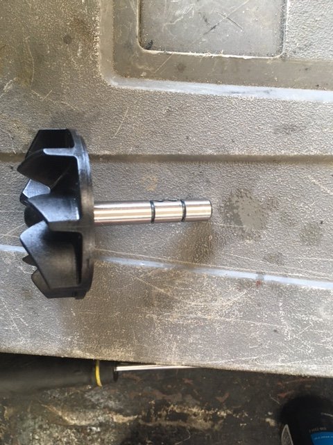

What kind of instructions did the water pump impeller come with (I'd be curious about getting a copy to see what the job entailed)?
Looks good Bob! Definitely getting me in the mood to start turning wrenches and tackling the bigger projects I have in mind for my SideWinder!
The impeller did not come with any instructions. I searched on the forum and found some good tips on the steps required.What kind of instructions did the water pump impeller come with (I'd be curious about getting a copy to see what the job entailed)?
for example:

After doing all the spring maintenance/improvements on my SW I never had a chance to ride it as the season was over. I rolled the sleds out this past week and got a chance to run the SW after the BOP auxiliary rad install.
Fortunately no leaks!
We have very little snow on our property, just enough to drive the sled on and temperature is right around freezing. With very little snow for cooling[1 3/4" track], no scratchers, slow riding and intentional idling the sled never went above 180F. The aux fan included in the kit cut in @ 180 and the sled stayed at that temp for the time I idled it. In the past the sled would have gone into limp mode under the same conditions.
Its all good!
