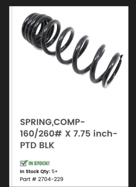

Cat has been using the same progressive rate spring on that shock since 2017. Stock it's a 90/250 spring (Cat pn 1704-736). Many of us (I weigh 200 ready to ride) felt it was too light on the initial compression causing heavy ski pressure with darting and some diving when getting on brakes hard. Lots of us have gone to a heavier Cat spring pn 2704-229 which is 160/250, or the Bill Mohr Stingray spring which is straight rate 160#.
I've run both and prefer the Cat dual rate spring because I can run less preload but still have good transition to stiffer 250 rate. Mohr spring is just linear.

2704-260 ?
Can’t find that spring .

This is close

YEah knew about this one, used it lots but never heard of the 2704-260 . Possibly another alternativeThis is close

Sorry. My typo. I corrected it. 2704-229.2704-260 ?
