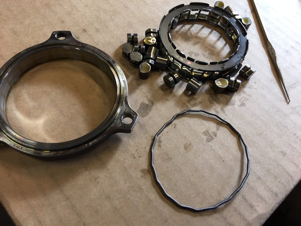

did you replace the starter clutch? If so what did the spring holding the locking rollers in place look like?
Didn’t...everything looked good no scuffs or marks on ring gear or flywheel/clutch...sled didn’t run when starter crapped out.

I was wonder if the spring was stretched. If it is the rollers won't return properly.
