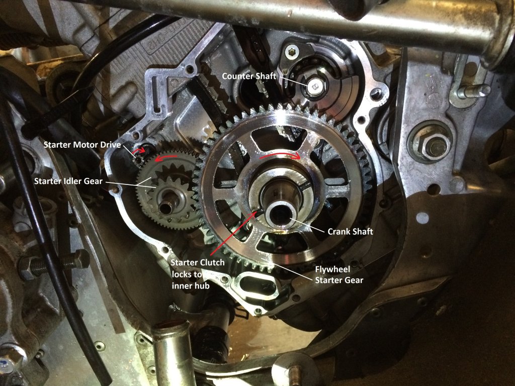

Stator cover removed to inspect starter gears (flywheel also removed):

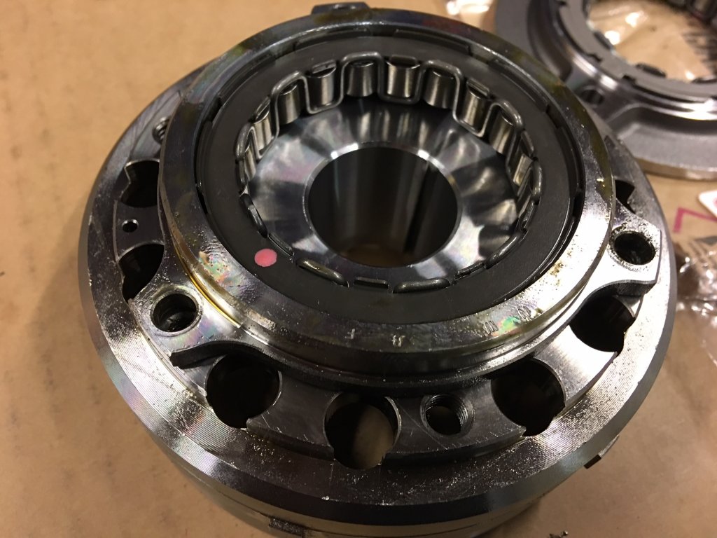

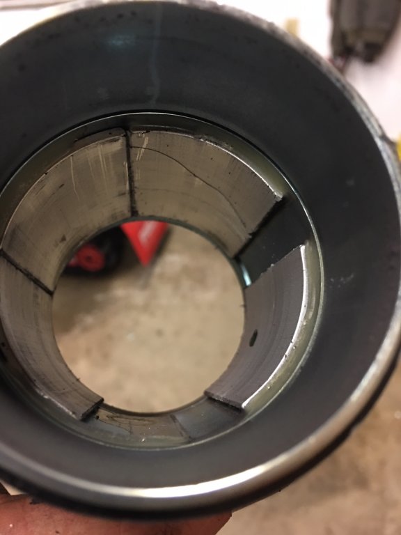

Starter flywheel gear with a bad one way clutch hub:

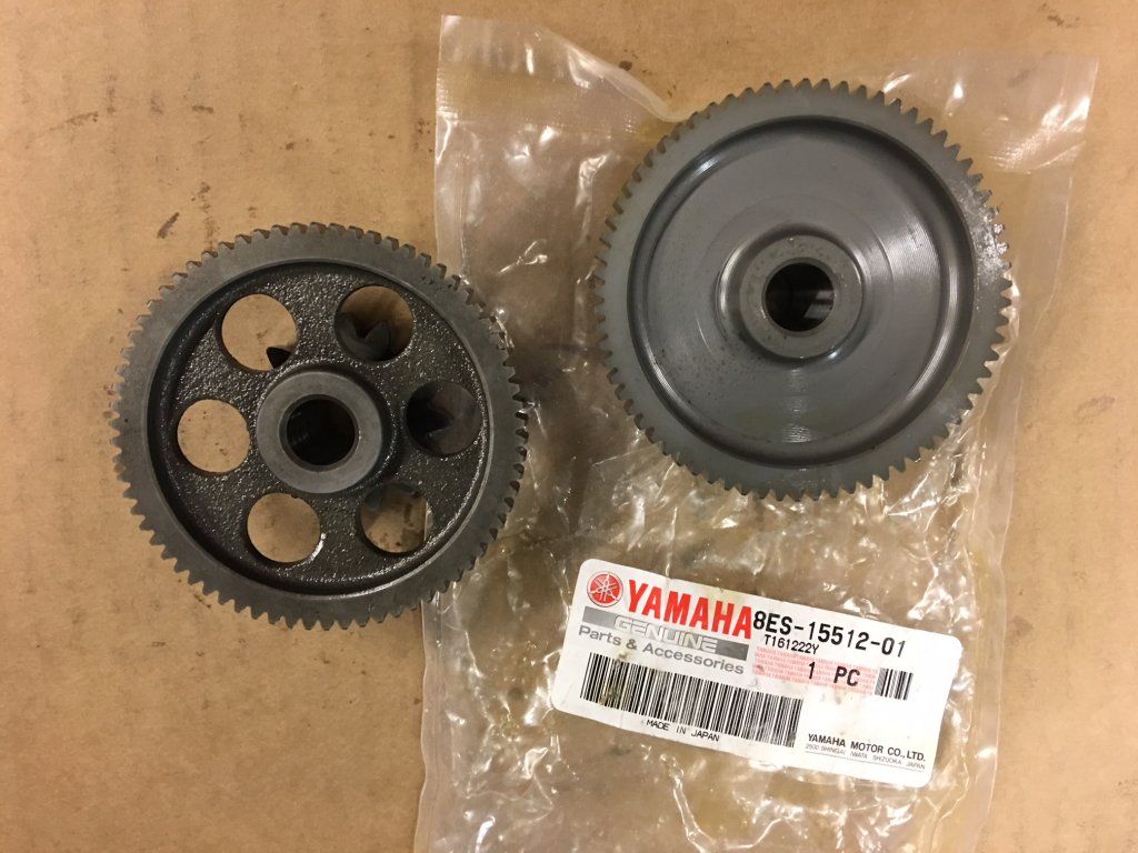

New updated idler gear. Notice that there are no webs in the gear and the teeth that the start motor's small gear runs on are now wider:

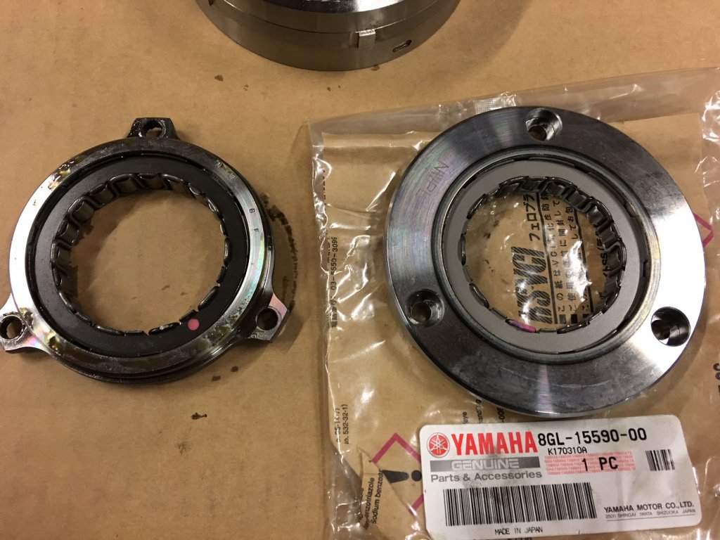

New updated one way clutch looks to be stronger than the old one:
Old one way clutch installed on flywheel:

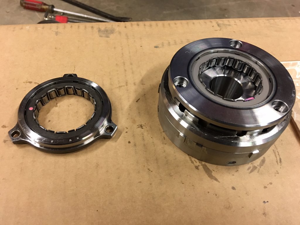

New one way clutch installed on flywheel:
