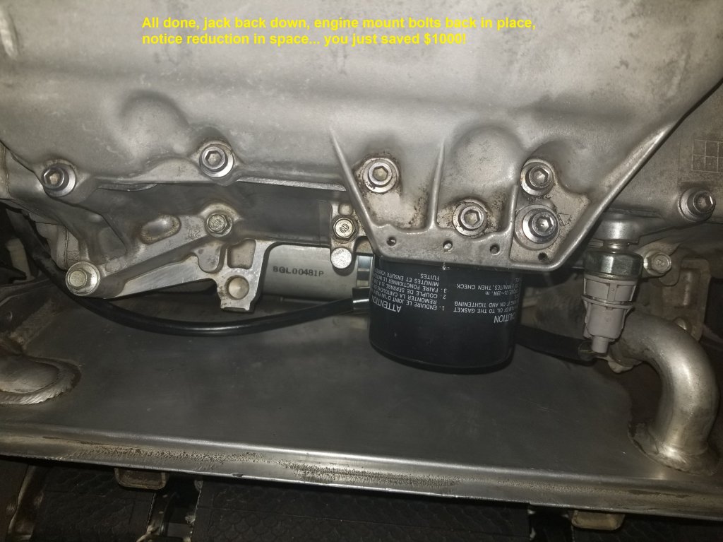

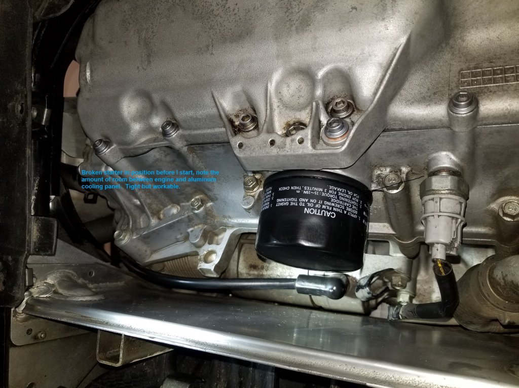

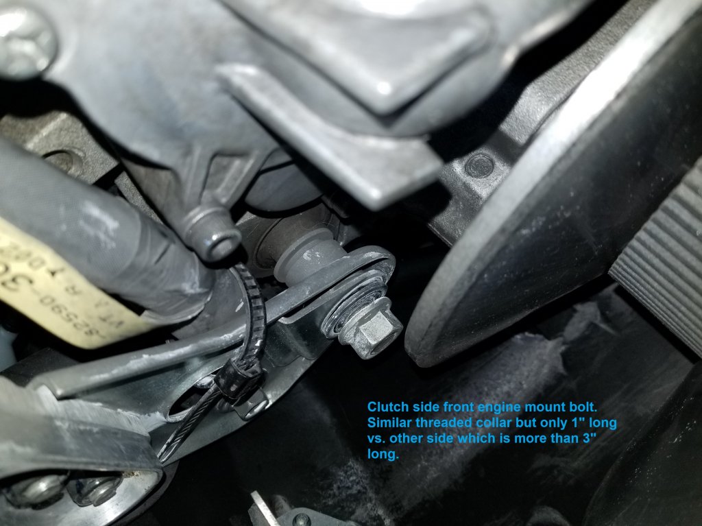

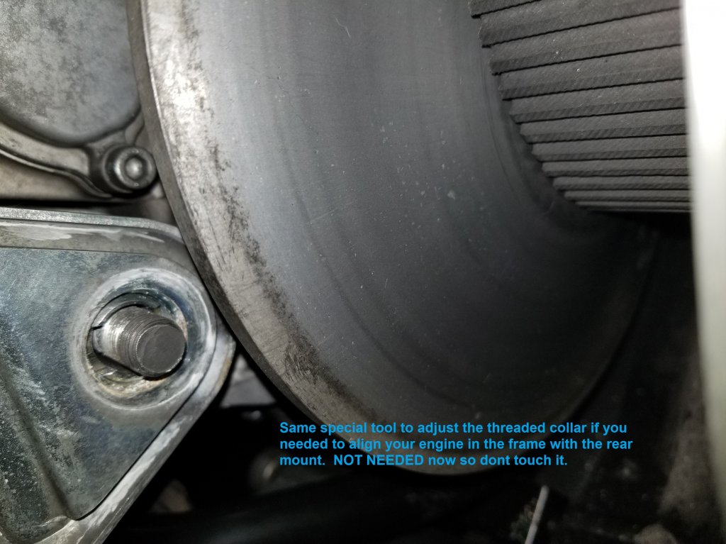

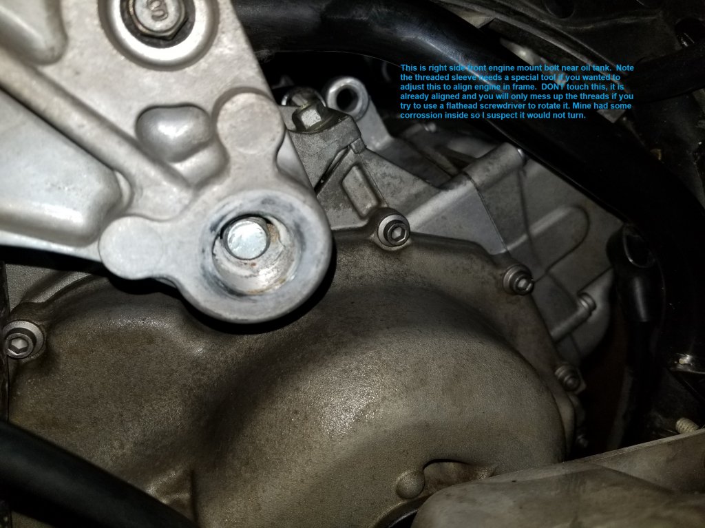

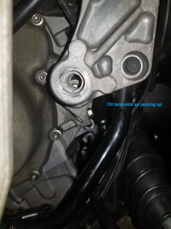

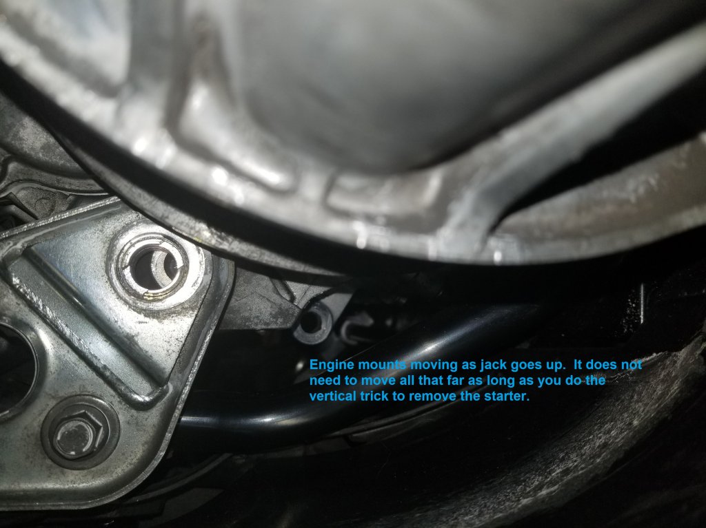

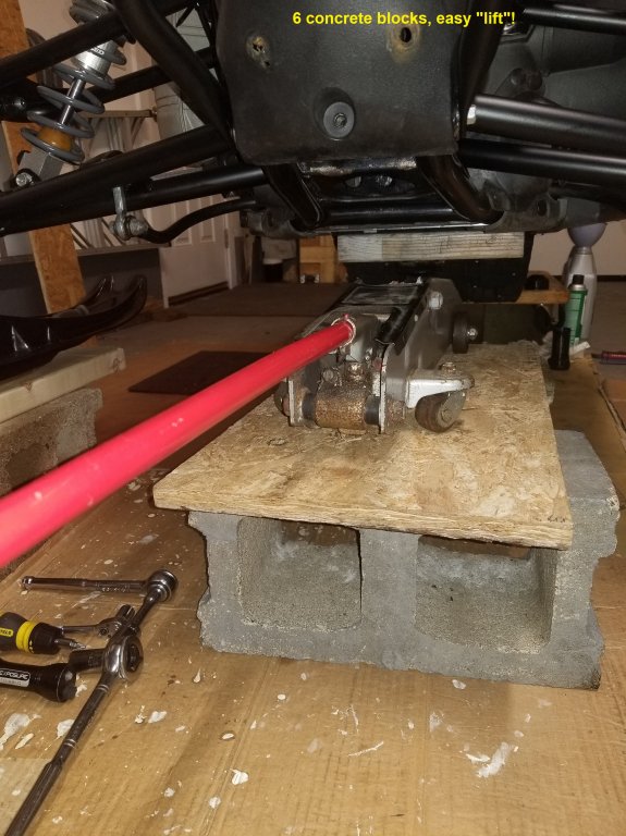

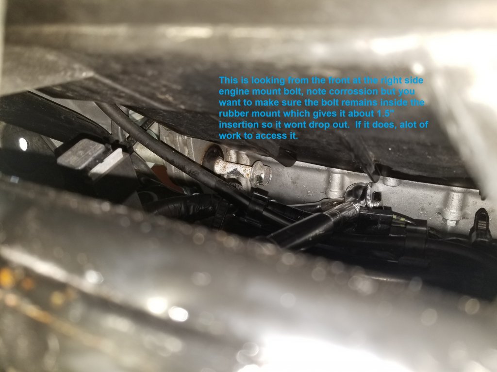

Success tonight! Here is the simplest method I have read about with pics and details what I did:
1. Place sled on four cinder blocks, one under each ski, two under track, position two more concrete blocks between skis to set floor jack on (optional put scrap 2x6 under each ski and track, 12"x24" 3/4" Advantec on blocks between skis for jack to sit on).
2. Remove the two airbox bolts, remove battery connections
3. Remove skid plate
4. Remove the oil sensor plug (push release is on top where you cant see it), remove starter wire, remove two 12mm starter mount bolts using ratchet wrench (things are tight so prepare for one click per wrench motion, be patient).
5. Remove oil filter (do not drain), only a 1/4 cup of oil will spill if you are careful, let dry sump drain until drips stop and then plug with small wad of paper towel. My oil was brand new so I did not want to change it.
6. Remove nuts on front engine mount bolts (nuts are on the outside), tap bolts in until they just exit the threaded engine mount collars (see pic), DO NOT LET bolts fall out of rubber engine mount on the inside, if you do, you now have to remove the forward plastics (a-arms, etc). They balance inside with just the rubber supporting them ok. Your engine will drop down a 1/4" once both sides are released. You DO NOT need to mess with the threaded engine mount collars, these are used to center the engine in alignment with the rear mounts which you have not touched. The rear mounts will keep the front aligned when you jack up so no need to try and use a flat head inside the collar to unscrew (this requires a special Yamaha tool purpose built - again not required, don't touch these threaded collars).
7. Jack up engine by placing a 2x4x8" block just behind oil filter, casting is built up here. You will lift skis off the ground as engine only really moves once suspension travel is lifted off. Some over pry the engine to create enough space for the starter to "drop out", if you go this far, makes sense some have mentioned feels like you are pushing things and the airbox cover may even hit the steering shaft. This is WAY MORE movement than needed if you thread the starter out vs. needed the clearance for "drop out" performance. Technique I used was pry end of starter free from engine, there is an o-ring that seals the gear on the starter so a little nudge is needed. Once free and the starter gear is clear of the engine rotate the starter vertically as there is "headroom" above the starter, this allows you to thread the starter vertically down in alignment with the oil filter mount between the two block castings that would otherwise prevent the starter from "dropping out". Using this technique you don't even come close to the air box hitting the steering shaft which I have not touched.
8. Have new starter ready and orientated exactly like the starter just removed and articulate the starter up vertically, over horizontally and insert gear (pre-greased gear and o-ring). Wiggle the starter and twist a little and the gear will slide into alignment inside the engine smoothly as you press the starter in until the o-ring seals the starter. Mount bolts will now be close to alignment. Inserting mounting bolts is tricky as there is not much room, I found the lower mount bolt could be inserted pinching the bolt as normal and wiggling into the hole and threading to align the starter upper mount bolt. The lower bolt has an oil sensor wire retainer clip so make sure to align it the way it was on removal (note this when you remove it). I spread open the clip so I could remove and re-insert the oil sensor wire easily after I did the upper mount bolt. The upper mount bolt presents an issue as I had to hold the bolt between two fingers like a cigarette and wiggle it into position without the dexterity of a pinch grip. Only option as this method keeps space near starter to an absolute minimum (preventing any removal of anything above the engine). Tighten and guess 19 lb-ft torque. Mount battery cable and tighten, slide oil sensor wire into clip, pinch closed with pliers, plug in the oil sensor wire. Re-install the oil filter (don't let oil in filter drain out). Congratulations, you just installed your starter and saved $1000.
9. Put a 12" and 6" 1/4" extension on a 17mm socket and carefully insert from the opposite side of the engine near the other engine mount bolt and capture the bolt head of the engine mount bolt and guide up re-insertion in the threaded collar, if you have a friend, slowly let the jack down until your pressure on the bolt slips it into the collar. Repeat on the other side again, for me the 18" extension made short work of aligning the opposite bolt and allowed me to put a torque wrench on both. The clutch side only an open end wrench could slip behind the primary sheave so I torqued it from the oil tank side thanks to the 18" extension.
10. Connect battery, test starter, mine turned over greased smooth... I installed a new starter relay as step 1 in the troubleshoot and a new battery so all new starter circuit.
11. Re-install lower engine cover and front plastic rivet to hold in place, insert side plastic tabs into lower engine cover,make sure all are flat interlocked together, place skid plate over assembly and insert four skid plate bolts. I retrofitted my frame with four C-clip nuts and bought 1.5" stainless bolts and fender washers, easy and strong connection once done as the bolts are sandwiching three layers of plastic.
12. Install upper plastics, hood, test starter again. : )
- This method saves not only the insane front clip removal, coolant drain, oil drain, total electrical harness release, brake removal, clutch removal, drive removal, engine removal after exhaust and airbox disconnect, but also from having touch the steering shaft or even removing the airbox cover! Hope this is helpful for the next guy as this project requires patience but only average wrenching skill. Good luck.

This is a great write up.
So - as you jack the lower pan of the engine, it rotates the engine up on the rear mounting bolts slightly to open up space to get at the starter?
Your pics of the mounting holes above, look like the engine is lower than these holes - this must be how they look prior to jacking?
MS
