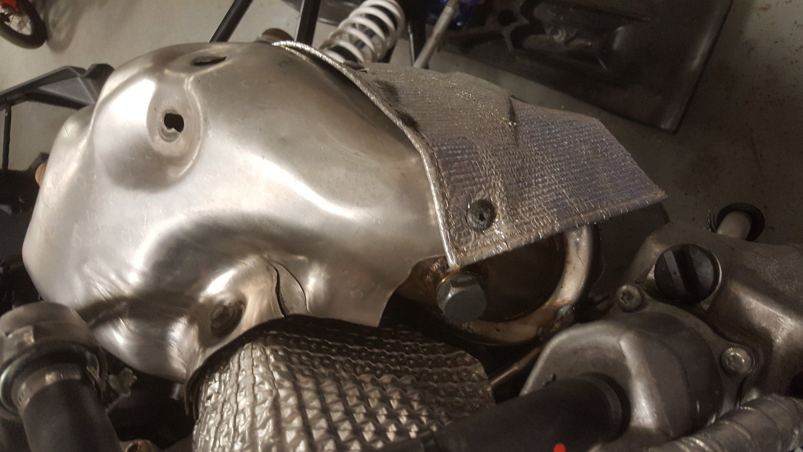

Was just mounting up the Viney Fab muffler. Doesn't look like there is any way the top heat shield that covers the turbo is going back on without major modifications. Has anyone run this without the heat shields? I would think you at least need to cover the turbo.Be warned that putting the stock shield and the insulation mat together keeps too much heat and muffler life is reduced quite a bit.
Best is to just install the shield no insulation.
The shields fit over our TD surperquiet exhaust
http://turbodynamics.mybigcommerce....-thundercat-sidewinder-zr9000-2017-2018-2019/
and the viney fab 3 inch tru muffler we sell. The viney fab is made for us and looks like our super quiet but 3 inch.
http://turbodynamics.mybigcommerce....r-998-turbo-sidewinder-srx-thundercat-zr9000/

Never mind, a little trimming and persuasion and it's back on.
