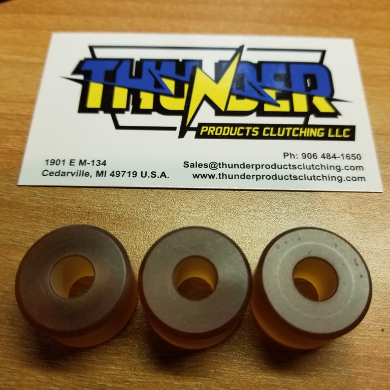

The 1st year (2017) of the roller secondary, the rollers are way too sloppy and flat spot immediately.
Yamaha was replacing them because they knew they were bad....but those are not lasting either and still are way too sloppy.
Our Thunder Products Clutching rollers fit perfectly, are wider and cost is $45.00 US
Here is a pic of the 2 side by side (2017 on the left and the latest from Yamaha on the right...notice the dimple marks)
Plus a picture of our rollers below

I can feel grooves in the ramps. One ramp is worn most, one less and next one hardly at all. Is this from loose rollers? 1200 miles. What is the inside measurement of your rollers?

Yes, from loose rollers.
Your 2019 should have the updated rollers in it also...but they are loose on the pin also. The I.D. diameter is .329 on the Yamaha rollers and ours is .319 making them a better fit on the pin
