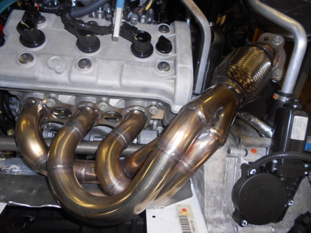

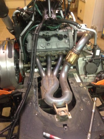

Do you use the stock heat shield, and does it have to be modified?Just ordered a Straightline header from Ulmer.
The header looks sweet.
Anxious to see how it performs with my MBRP can & Excel Intake.
What a difference between Straightline and Stock exhaust.
View attachment 111720 View attachment 111721
I just installed mine last weekend in front of my turbo... fit was great, should spool her up quick now! I picked mined up from Straightline right at Novi. Uses the stock heat sheild, the only modification was we trimmed some of the aluminum out in the front that they say to bend down, but other than that, very straightforward install. Look forward to some snow to see the improvement.

Just wondering, how is the clearance at the gas tank and is there a heat shield that comes with the header??
- Apr 17, 2003
- 5,566
- 2,003
- Menno, SD
- www.ulmerracing.com
- Menno, SD
You reuse your stock heat shield. Clearances are the same as stock, as the stock heat shield covers the header, no fuel tank issues or heat shield issues.
