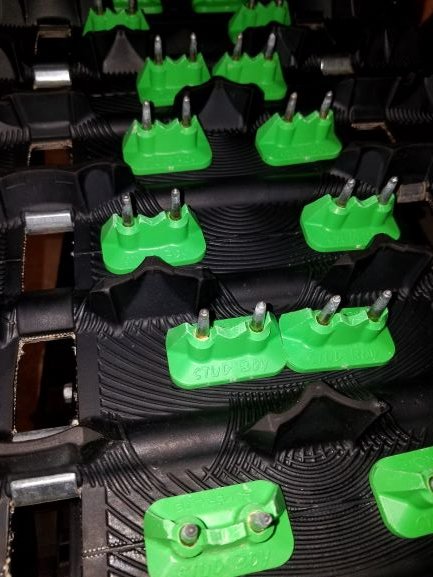

I went with a set of 192 1.625" single ply (bigger head to prevent tear outs) up the middle on my new ripII 1.5.
New track is on the left.
