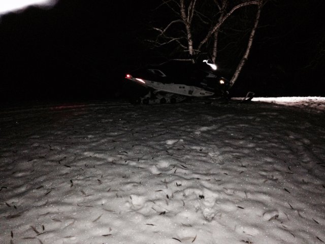

Only jumps and plowed field to test on tonight. No big whoops. But so far I have nothing to report. I feel nothing in rear. It's awesome! I can't really explain why but now the front feels way more planted also. Limiter straps all the way out and transfer blocks on 2. I believe the way faster rebound is what did this. I bet it won't push anymore. Heading to buddy's mx track tomorrow to hit his whoops section. This is stock shocks with carver Mod and valving which I installed myself. Stock springs on soft. Very happy!

145 lbs. We lost our snow and had muddy MX track so I didn't get to do any further testing. I will try to get there this weekend if it's not to warm again. SXR give it a chance. Mine felt same. So much more compliant I thought for sure it would bottom. It hasn't! I have jumped it 5 or 6 ft up. No bottoming yet. Big test is a high speed G out. Haven't had that chance yet. Now my suspensions is working. Hopefully not too much but my god what a difference!
