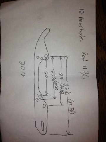

Does this ever sound familiar......I did the same thing to the XTX long track by that I mean measuring my M8 to get diff mounting holes.

Just the rear arm. Front mount points are same on them. I had the two skids sitting side by side last winter so I saw the difference. Never measured till now. I looked at mine last night and I don't think I will be able to do what I want since the rail has a cutout right where the bolt for rear arm would need to be. If you look at what it would do is the scissor would be closed more. This would make the back lower and put more leverage on the rear shock from the suspension. Short of getting different rails only thing that can do is shock valving but it will never be the same as 12 without moving that arm.
I really wonder if what they did was a result of so many people who freaked out because there sleds had 3-4in of what felt like nothing as far as dampening and spring pressure. Hear it all the time on cats and Yamahas. On a 12 cat if you take the skid out with springs unhooked and push the rear arm down it will stay there. On ours just the nitrogen pressure of shock is enough to hold it up forcefully. When you push it down it is as if you are directly compressing shock.

Wish we had snow to actually ride mine and give a review of the complete revalved package with softer torsions, granted it's an ltx and not an rtx but were trying to accomplish the same thing. As far as the ltx skid there really is no place to move anything since there are so many holes in the rails, nether the linkage or the shocks can be moved cuz there's no place to mount them with the rail style. One guy in our grouped looked at doing exactly what you're talking of doing to his ltx but same thing, no where to mount it other than stock settings
Yes I wish it weren't so but getting perfect valving is all that can be done. Remember how many optional mounting holes used to be in cat skids? Is a shame they went away from that. I am fairly happy with my valving now. Just don't like the "hot rod" position sled is in unless I am hard on the gas. Should transfer with less throttle than it does now.
