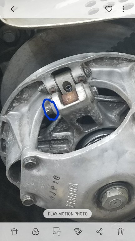

Just bought our new S-TX GT Friday, put 22 miles on thus far, love it! But, noticed that clutch disengagement noise? Clutch noise? appears to be this subject bolt noise. I just started new breakin... not overly concerned, have watched a few videos of same machines in the mountain snow - same noise. Only when driving - clutch disengaging? ... Will look into the bolt washers...

The only way to quiet the OEM Yamaha Primary,[or drastically reduce noise], is Hurricane's noise reduction shaft[no longer available] or their noise reduction ring they still sell. Pretty pricey but I have had their noise reduction shaft on my 2019 SW since new and it is still WAY quieter then all my buddies SWs clutches.

Is your sled stored in an outdoor trailer?View attachment 165207not much to see...

Not much you can do to quiet the stock primary, but it does work well. Be sure to watch for roller/bushing wear over time. If you keep the stock tune you will be fine.copy - thanks for the info. Shouldn't have to do anything like that on a brand new machine 34,000.00 ridiculous lol

If you're running stock power an option is the Umatek clutch. I have a couple customers running them, they are very quiet.
I run the stock clutch and I grind the roller pins shorter so they don't slide back and forth and I also shim the buttons with Polaris shims to keep the clearance at the minimum of spec. I also use the knockout kit, but it has been met with skepticism. Personally I like it.
