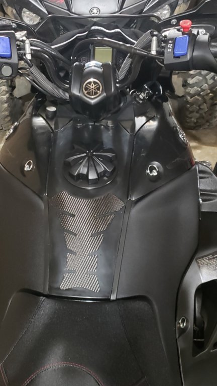

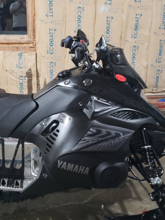

Just finished installing the trail tank and I am very impressed. I am probably the fussiest person on the planet and fit and finish is important to me. After reading all the reviews I was on the fence about buying one but this latest version fits like a glove. It dropped right in, I never had to force, pry, or bend anything. Actually goes in easier than the oem and they made enough room to keep the vent line where it is. The hood panels fit nicely and I don't think most people would even be able to tell its a different tank. My only small gripe is the dsus; the oem are slightly to small and the ones that come with the tank are slightly to long. I will be looking for something between the two. If your on the fence like I was and are reading reviews after reviews just get it you won't be disappointed. It will be so great not looking for gas every 80 miles.

Lets see some pictures. All of them that I have seen look horrible.

Good info MP5, and Mr. Sled I will try to get some pictures up once I finish a track swap. Ty4 is a pain to get pics up and Chaincase is ripped apart at the moment. The really only fitment issue is there is about a 1/8 to 3/16th inch gap on the hood panel around the gas tank shroud but they are equal on both sides and i don't think most people would even notice besides me. My sled is a 2013 so it has the tunnel cooler and I have the moflow vent above the radiator so hopefully overheating will not be a problem. Does the tank look oem? Well pretty close but no its not yamaha fit and finish but handy. Yes the hood panels do fit tight with the oem dsus fasters make no mistake about it. I trimmed the gas tank shroud and added trim to both sides of it so looks pretty good and im satisfied with it fingers crossed no leaks or other issues. Fitment of the tank on the sled was a breeze really.

WOW, they have come a long way. Much nicer!!
