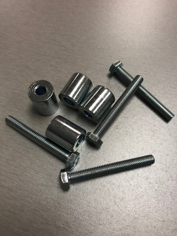

What length bolts did you go with there?I stopped by my favorite True Value hardware store on the way to the office this morning to get some longer bolts to shim the radiator. I found these steel spacers that have a 1/4" ID x 3/4" long for $1.55 each that would make the install pretty clean I think. G.B.

50 mm. They are a touch long but wont hurt anything. If you could find or cut them down to 45 mm they would be perfect with the 3/4" spacer.What length bolts did you go with there?
The Trail Tank seems to fit great now with all the spacers accounted for and rerouting the gas tank vent line. The studs on the tunnel are as far rear in the tank slots as possible. Next up I am going to dump 5 gallons of gas into the tank and check for leaks. I am getting ready to pull the sub frame so I will hold off test fitting the body panels with the Trail Tank. Thanks to everyones help and input on this thread, especially herndonp! G.B.
