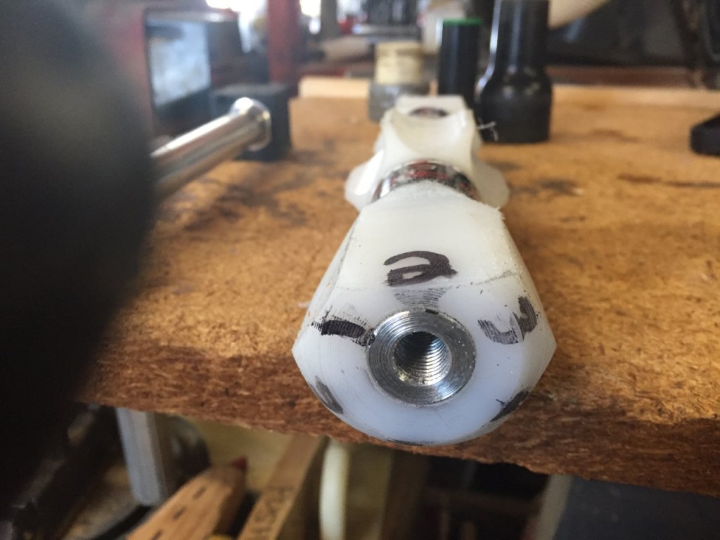

OK i ground down my stock blocks & my Racewerx to give me more adjustability.
STOCK .... NOW
0=6.2 mm .... 0=6.2mm
1=14.8mm .... 1=12mm 1=14.8mm
2=16.2mm .... 2=9mm
3=17.7mm .... 3=17.7mm
I removed material on a belt sander. I used the #2 setting to grind the lowest because i felt the flat part on the shaft would hold up better although i think i went a mm too far. I also ground down the #1 to spread the numbers more evenly for more adjustability.

I ground down the #2 ramp because there is a set screw i was afraid to hit on the previous ramp. More may be able to be removed, but i didn't have the sled with me so i wasn't sure how far i could go before the angle would affect it. I figure 10mm to 18.6mm is some good quick adjustment. If it works ok, i might try to shave it down to 8mm which is close to blocks removed & touching bare shaft. Riding next weekend. To be continued.....

so steve...after your mod...the 9 and 10 mm respectively equal the distance to the center of the bolt? and judging from your "I took 1mm too much off" it would be 10 and 10 mm?

I measured to edge of hole because it was more accurate. The hole is 8.75mm if you want to do the math. I was able to get the caliper in further & it stayed square. Also the stock ramps have a little taper so i wanted to get as close to middle as possible. I also noticed the stock blocks had a dent in it showing this material will wear after a while so the 10mm was probably the safest to shave down. I think i can get the Speedwerx to 8mm which will probably match the bare shaft with some sort of rubber or plastic on it like some guys did.so steve...after your mod...the 9 and 10 mm respectively equal the distance to the center of the bolt? and judging from your "I took 1mm too much off" it would be 10 and 10 mm?
