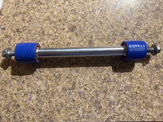

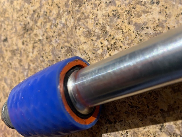

Pull blocks and metal rod, Put heater hose over metal, line up angle. The rubber does absorb shock but does wear out some over time. Needs replacing after some time but it will transfer. Without studs not sure you will get what your wanting on a 137 coupled

1" I.D. >heater hose.. Black stuff usually readily available at auto parts store. I usually wrap a little electric tape first then a piece of heater hose. The stuff in the pics is silicone version of 1" heater hose. Couple things about this. I leave my straps out, I do not pull them up. Also Some have not put anything on the rod and have no issues. I set up sleds suspension so I do NOT ride on the blocks . When you sit on your sled it should sink about 2-3" inches IMO. If your riding around on the blocks the heater hose will wear off quickly.. I see sleds all the time that do this, and its a matter of preference I guess. But if your not able to only have 2-3" on sag then you need heavier torsions springs, a shock rebuild, and or go on a major diet.. No offense.What robber hose are you using? Do you also let out the limiter straps?

1" I.D. >heater hose.. Black stuff usually readily available at auto parts store. I usually wrap a little electric tape first then a piece of heater hose. The stuff in the pics is silicone version of 1" heater hose. Couple things about this. I leave my straps out, I do not pull them up. Also Some have not put anything on the rod and have no issues. I set up sleds suspension so I do NOT ride on the blocks . When you sit on your sled it should sink about 2-3" inches IMO. If your riding around on the blocks the heater hose will wear off quickly.. I see sleds all the time that do this, and its a matter of preference I guess. But if your not able to only have 2-3" on sag then you need heavier torsions springs, a shock rebuild, and or go on a major diet.. No offense.View attachment 163717View attachment 163718View attachment 163718View attachment 163719
