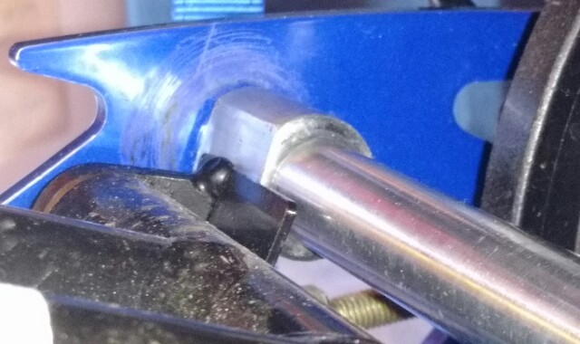

I used to take the black blocks out and sand them down thin on setting #1. Then you can put them in and have more contact area. You can also move the shaft down and back. Did that on a couple sleds before I started making the shocks better. Drill another hole 1/4" away from the stock hole and it makes a big difference.So I strapped the back down to line things up. Yuck! I don't see this being awesome. Barely hitting the rod?
I'll give this a go. Wish I had a sander. Hmm.....
On trick to these things is to just tighten the bolts for shaft lightly then jump on back to force scissor into the blocks or rod.This positions the flat to the flat of scissor. Better yet is to have a big buddy sit on bumper doing the same and tighten the shaft bolts. If its not perfectly flat to flat the blocks will break or if no blocks will damage the arm.

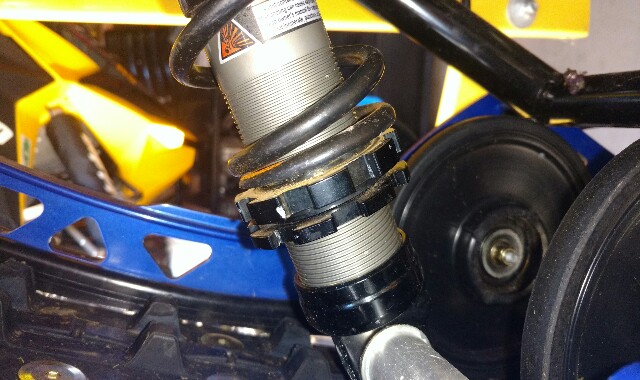

Ok, what about this. Front skid shock. Spring has zero preload. I cannot loosen collar to adjust spring.
1) Tried spanner to loosen up. Nothing.
2)Hammer & screwdriver to chisel it loose. Nada.
Suggestions??

If the little mark on the upper ring is from the hammer and chisel, then you are hitting the wrong ring, not trying to be a smart #*$&@, just appears that was the one being hit.Ok, what about this. Front skid shock. Spring has zero preload. I cannot loosen collar to adjust spring.
Bottom collar to the left. Top. Collar to the right. Just to break it loose. Is that right?

Loosen the bottom collar first.

Ok.....I'll tap it on the left. I'll try a squirt of something. It's obvious I didn't beat anything up. I was like tap tap tap. Nothing. Then went to top, tap tap tap nothing.
The factory cranks the living snot out of those. Big hammer and a nice piece of aluminum does least damage. Big Screwdriver and big hammer does trick too but will nick it. By now you probably don't care though. Hit it like you mean it! One nick is better than many.Ok.....I'll tap it on the left. I'll try a squirt of something. It's obvious I didn't beat anything up. I was like tap tap tap. Nothing. Then went to top, tap tap tap nothing.

Its kinda like when you double nut something, best to spin both at the same time, in opposit directions. Even with the spanner wrenches, its hard to do while in the chassis. Soak them down with something, try to have someone else hold one, while you WHACK the other.

I won that battle......
I think I'm better at riding them than I am at working on them. But not by much. Lol!
