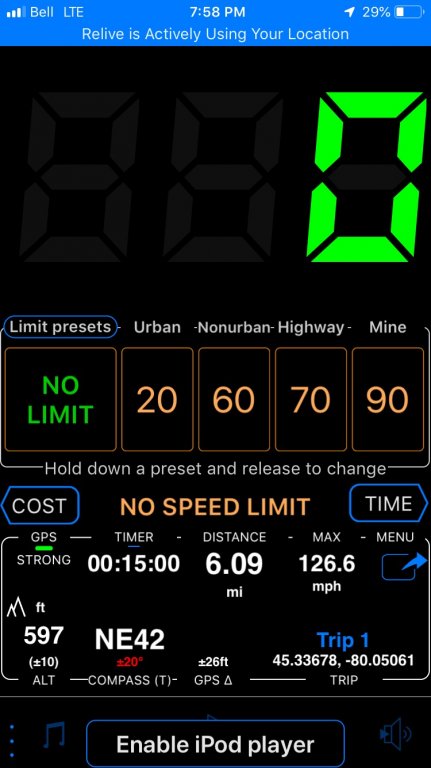

My brother just picked up a 2019 SRX with 2700kms. All stock except for a 22 tooth upper gear and snow trackers on the stock skis. First rip on Georgian Bay this evening. Love to see how fast without the trackers! This thing is a rocket.
I take it you are studded and Georgian Bay was ice, if not that is veryyyyyyy impressive for a stock anything on snow!!!
I am still impressed if it was Ice, that is fast.

Yes ice and studded
