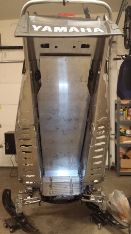

Finally was able to get some miles on the sled this weekend. After about 100 or so miles the plate is still in good condition and my tunnel had much less ice than my buddy with an XTX w/ no blockoff plate. I had some on the sides, not much on the plate. He had a bunch all over.

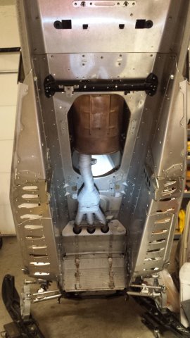

I just did my xtx and mounted my plate to all the same rivet holes and brackets (to the rear) that the tunnel protectors used. I used a chunk of a 5' sheet of aluminum and went almost the full length including the bends to butt it up with the heat exchanger. There were only a few fitment issues at 15.5" wide towards the rear and bolt on each side at the front. We'll see how it performs on my U.P. trip next weekend.

What a job, you even dropped the entire track out of the way. Please report next week on the results, I am sure it will be a success. You rock.

Hey mj did you bend the sides up to the tunnel and bend a lip to mount to tunnel if the protectors are gone? I really like the clean installation and would like to copy it. Thanks.

without tunnel protectors you'll need to either flange the block off plate and attach it directly to the tunnel or use standoffs between the tunnel and plate to space it. If you flange it I'd drill some holes in the side flange for air flow.
