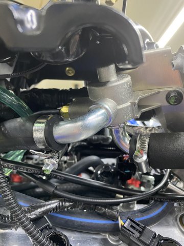

I have three hoses going into my stock intake but only two attachment points on my TD CAI. Am I doing something wrong? Pics below. Thanks in advance!
Stock intake box with red circles showing hose entry points:
TD CAI with red circles around hoses:
Part where the larger diameter hose from the intake box goes. What is this part?
What is this piece? When I disassembled to this point, it didn't look like a hose or any tubing was on this.

bottom picture , vent tube from chain case , this is normal
fourload
Third picture is rollover valve. I see they moved it to the middle of the sled likely to keep it warmer. I would call TD and get an answer.

Thanks. I did some looking on TD's website, and it appears they have a '20 specific CAI to account for the rollover valve vent hose. I already emailed Mike to get it squared away!
