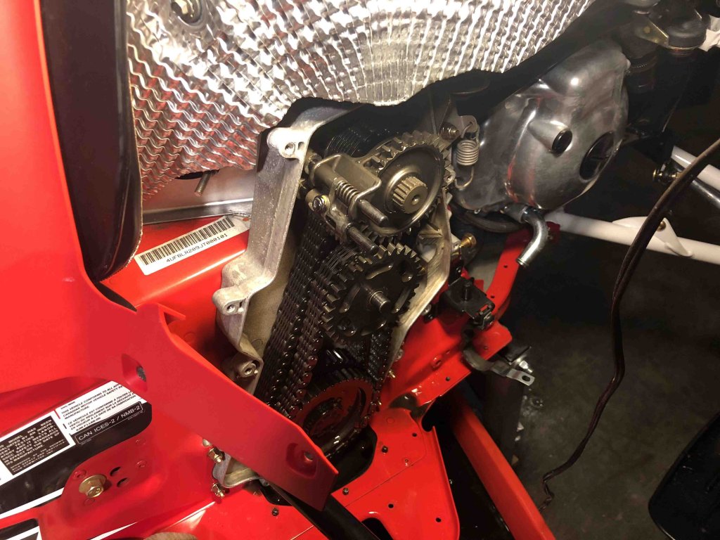

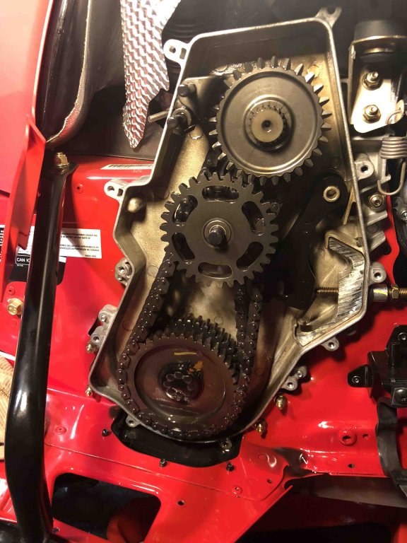

Hey Dan, Great pictures as always. We offer a solution to the top gear issues on these sleds.Chaincase

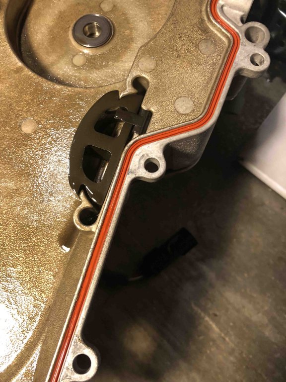

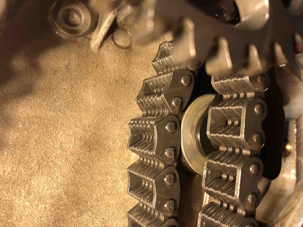

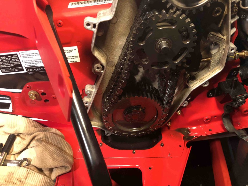

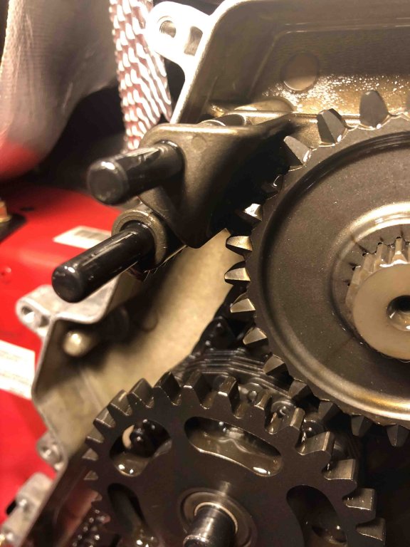

Part 3: Case opened
Cover should now pull straight off.

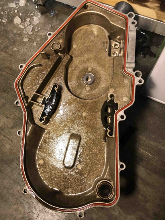

IMPORTANT: First thing to look for is one thrust washer that for me stuck to the cover, Its place is on the post outside of the center gear(not top or bottom). See Pic 3 below.
NOTE: Thrust washer as it stayed stuck to cover
Gasket/seal seems to be fine....

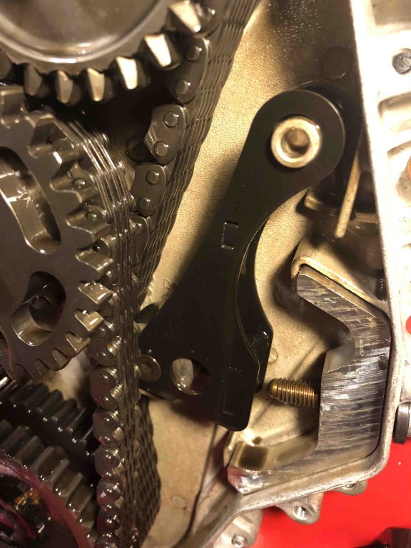

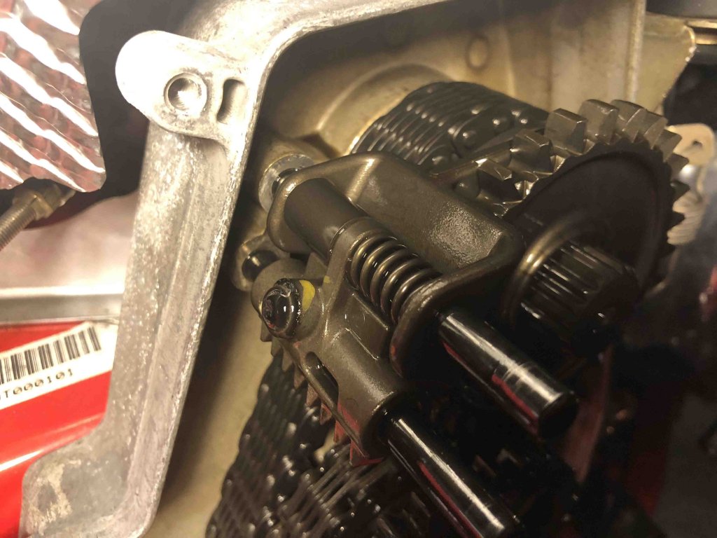

Notice the space between end of tensioner bolt & tensioner, 1.5 turns out.

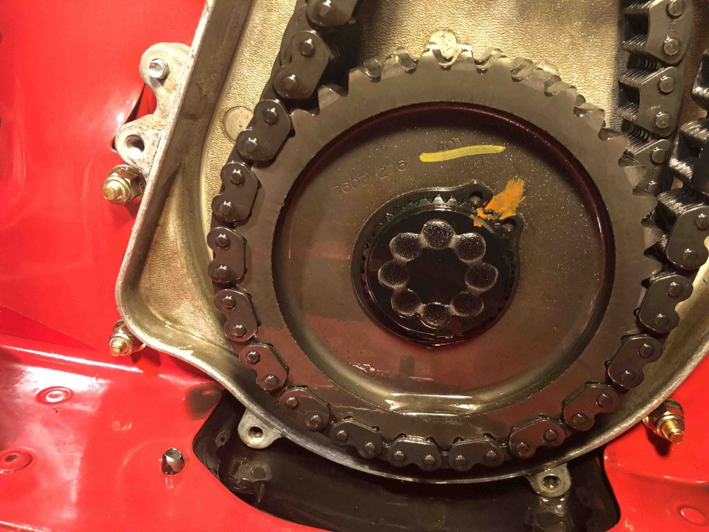

Bottom drive shaft on the end, has a nice strong magnet here...Good work.

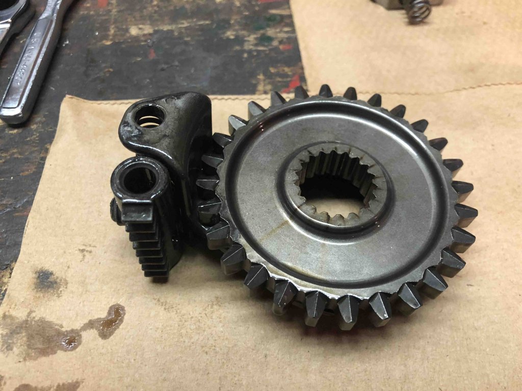

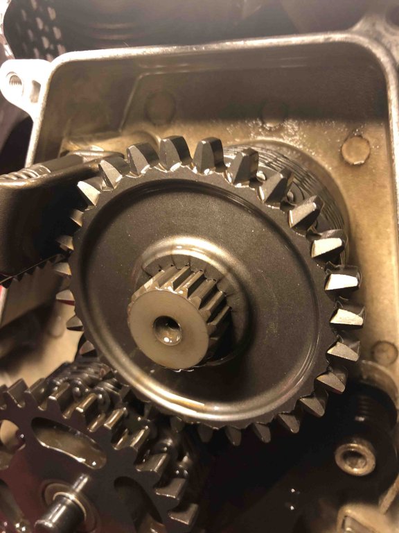

Removing the sliding gear and fork from top, this slides right off of the two posts.
View attachment 136008 View attachment 136010 View attachment 136011
