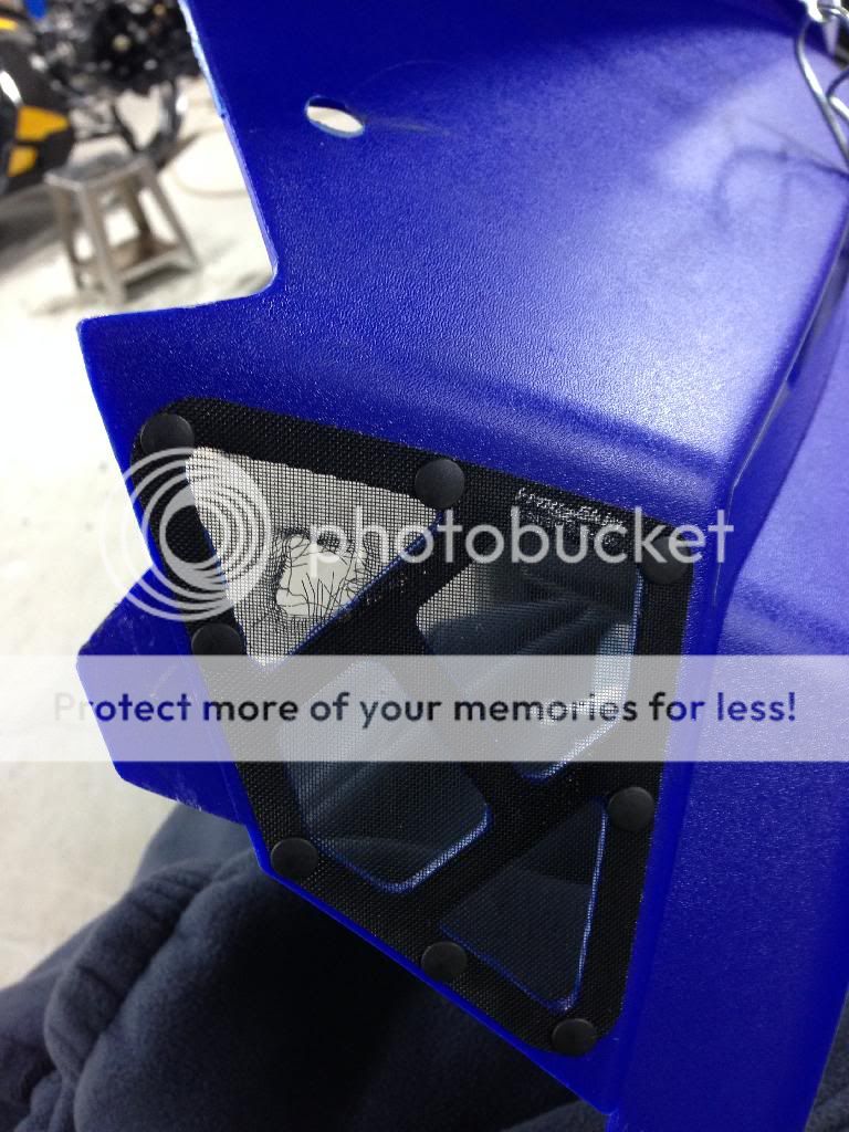

i have a koso digital guage. it reads 6 psi under full throttle but will jump up to 7-7.5 when i let off the throttle. is this normal? i really dislike the venting screen mcx includes in their kit so i put some frogzskins on.

You don't need the MCX vent we did not install and have abused this sled in deep snow breaking trail with zero heat issues so it is not needed in trail form.
You might get a momentary boost spike when you back out of the gas before the BOV opens.
